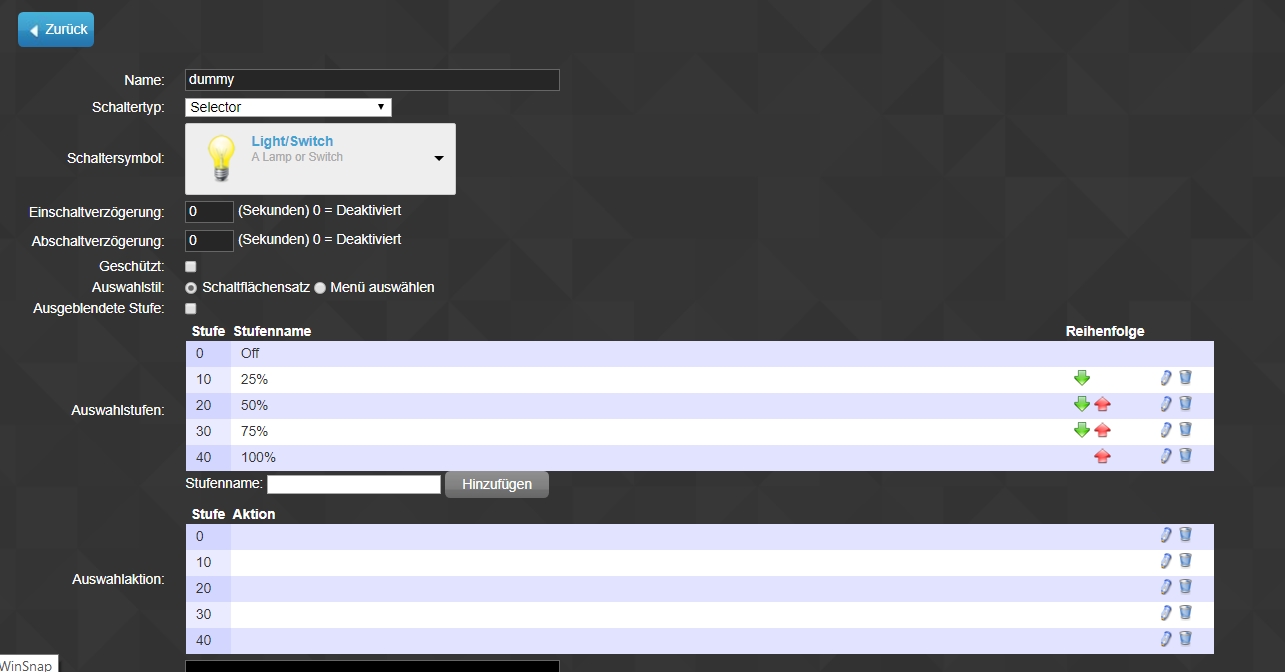

hello, I can not get it to control the blinds with a dummy switch.
My intention was that I do dummy as a selector and then stop level 10, 20, 30 40 times the blind stops.
But do not get it set up in Blockly.
Could help with someone?

Create a shell script with the corresponding open/sleep/stop commands and execute those with the selector switch.

Post by Egregius » Monday 28 May 2018 20:26
You start by searching the wiki.
And then you create a script, for example: /home/pi/openblind99.sh
#!/bin/bash
curl -s 'http://127.0.0.1:8080/json.htm?type=command&param=switchlight&idx=99&switchcmd=On'
sleep 4
curl -s 'http://127.0.0.1:8080/json.htm?type=command&param=switchlight&idx=99&switchcmd=Stop'
make the script executable:
chmod +x /home/pi/openblind99.sh
add the script to the selector switch with the full path
scipt:///home/pi/openblind99.sh
