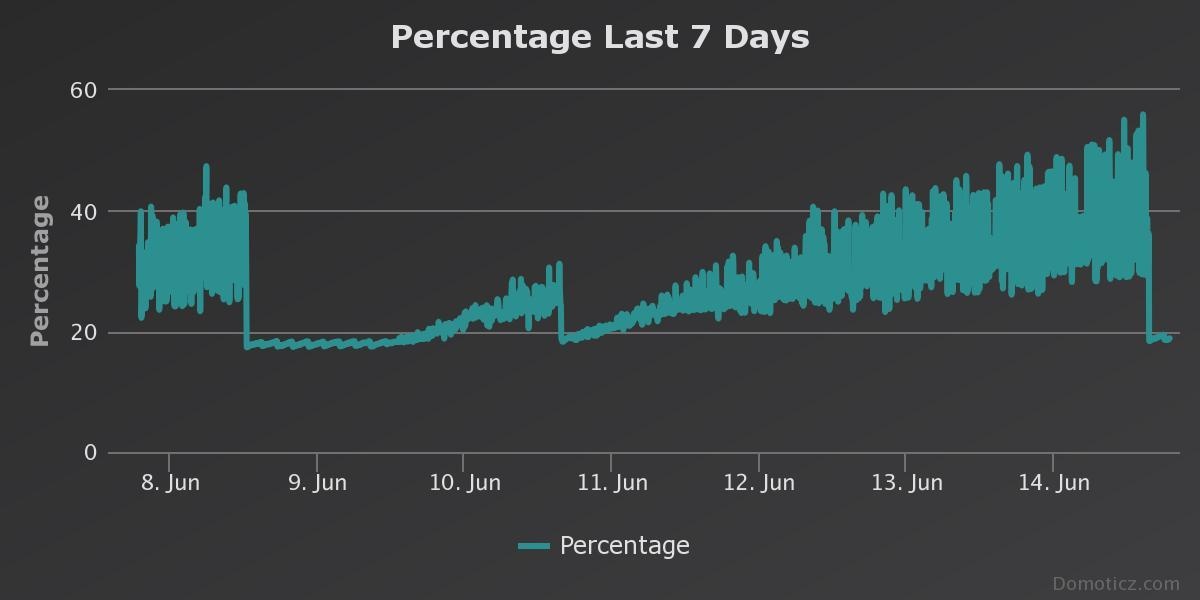

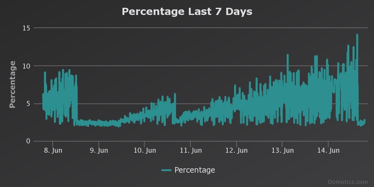

Hi I have the following problem I use a Raspberry B with msata disk running Domoticz so far no problem. But when I install Nefit Easy(it works great, all 10 sensors) the processor activity is higher and higher beginning with 1.5 % and every day 1 % higher. I have looked to the tasks and the Node task is making the high activity. I am not a Unix expert, and 69 years old, never to old to learn something. But I would ask, have someone an idea?
SweetPants
Posts: 2274
Joined: Friday 12 July 2013 21:24
Domoticz version: V4.10067
Re: Nefit Easy™
Post by SweetPants » Tuesday 12 June 2018 13:39
pa3gmi wrote:
Monday 11 June 2018 21:03
node is Java based and Java based applications are "famous" of taking a lot of CPU and memory. But I run on Ubuntu and have 4Gb memory and 2 Atom CPU's. I have been running the easy-server for as long as it exists, but do not see any significant CPU increase for days/weeks/months. Maybe search the internet or node user forums if this is a known issue. At least is does not sound as a Domoticz issue.
My 2cents, Harry

Post by pa3gmi » Wednesday 13 June 2018 8:13
Hi Harry,
You are right that it is not an Domoticz item, with only Domotics and a my sensors gateway an RF-link Gateway no problems at all, so there must be something in the easy-server that make my pi upset. Is there a Nefit easy server forum? i can't find it.

I have sinds last month also problems with memory ans CPU use then Nefit-easy services is running.
After 1 of 2 day the services crasht and must be restart with "PM2 restart 0"
(On 8 jun the services crasht, 10 jun I reboot the RBP, 14 Jun the services crasht also)
I use node v6.14.3 and easy-server 4.0.1 and pm2 v2.10.4
Have somebody a idea to resolve this problem?

I see more people having problems with that, I use node -v (versie 10.4.1)
npm -v (6.1.0) easy-server -v (4.0.1) pm2 -v=2.10.4 and Raspbian stretch kernel 4.14
Another thing I see today, in the hour gas log I see 0.012 m3 gas at 7 o clock in the morning, further no usage. In the day gas log I See 2.203 m3

I'm also still experiencing the same problems, and hoped the investigations of robert klep would fix the issue
configuration
Raspberry Pi reference 2018-04-18 (9 (stretch))
node -v v8.11.3
npm -v 6.1.0
as mentioned above in my previous post i don't use pm2 to run the nefit easy server (but i didn't remove pm2)
when i look at the pi memory historychart the increase of memory (and also the increased cpu usage) started around 29th may
so i asume something changed around that date in domoticz or in the nefit easy server package or at bosch/nefits webservice (or a combination of them)?
@others when started the memory and cpu increase for you?
when i look at the release date of easy-server 4.0.0 was 29th may and 4.0.1 was 30th may
it looks there could be a relation ...
maybe the reason for the new easy-server releases was a change at bosch/nefits webservice.
and somehow the fix doesn't work in combination with domoticz :cry:
what todo to get this fixed?

My memory and cpu also goes up. I never used pm2, so that's not the problem I think. I did start to use pm2 as my internet connection isn't perfect, and when it's down I need to restart the easy server, which I'm able to do now with a lua script and pm2.
